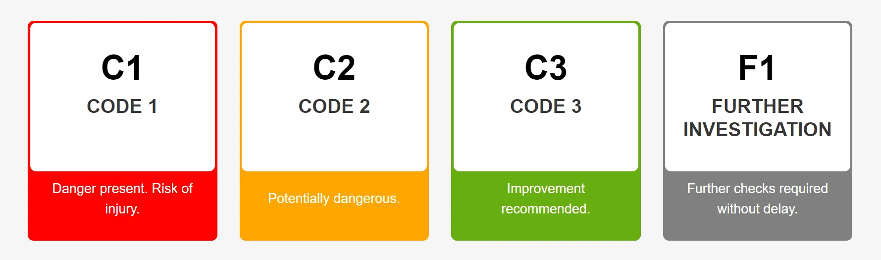

So, I'm a lessor and I have a 3-bedroom apartment that I rent out because I need extra income. I'm old and divorced so I need to support my children and old wife, we have remained friends after all. Anyway enough with the storyline you might figure out who I am. So, after the Electrical Installation Condition Report, I got all C1 C2 C3 problems. Attached is what it means. I'm scared that I would spend so much on replacement of the fuse box and the engineer who my friend referred to me really did not give me options. I want to ensure that I can fully comply without full fuse box replacement. Some of theproblems I have:

c1 issues require immediate action to eliminate danger while C2 needs urgent fixes to prevent potential hazards. for c3 improvements are recommended but not mandatory. combining 2 ring circuits or isolating into radial circuits with b20 breakers could be compliant but it depends on the specifics of your installation. consulting a qualified electrician for tailored solutions is the best approach to ensure safety and compliance without unnecessary expenses.
