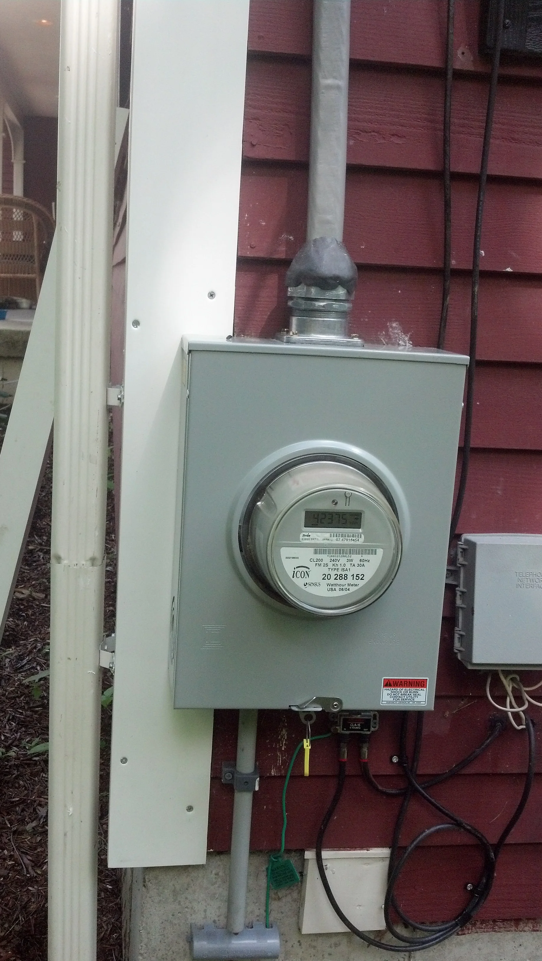

But as told above I DID get a new panel, new feed wires, attached pic shows (top) putty sealing the conduit to meter box, then there's a can't-see hole in the house wall, behind which in basement (INSIDE) is the panel. Panel/breakers 5-6ft above floor in a very dry and not-prone-to-humidity basement (foundation/cement-walls never leaked). Typical setup/design I assume...I've seen worse-looking setups lasting way more than 20 years!...such as....
