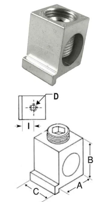

In obsolete panel boards & load centers, I've used a Turn Prevent lug. Remove the set screw from the existing bar and replace it with the proper thread machine screw & external toothed lock washer to hold the lug on top of the bar. (Sample photo of Turn Prevent is below)

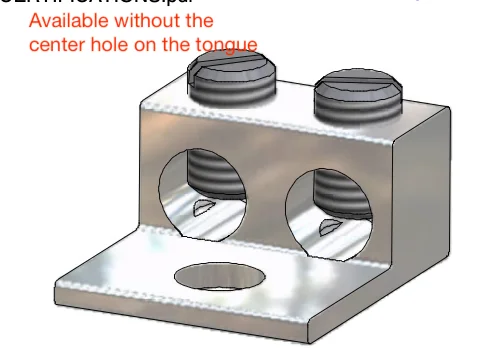

Plan C would be to take a wide tongue lug without the tongue hole and notch a space to leave two legs spaced to fit under the existing bar's set screws.
A sample photo is below. A drilling guide for lugs is also below. (Sample photo below)
    14.1 KB
    17.4 KB

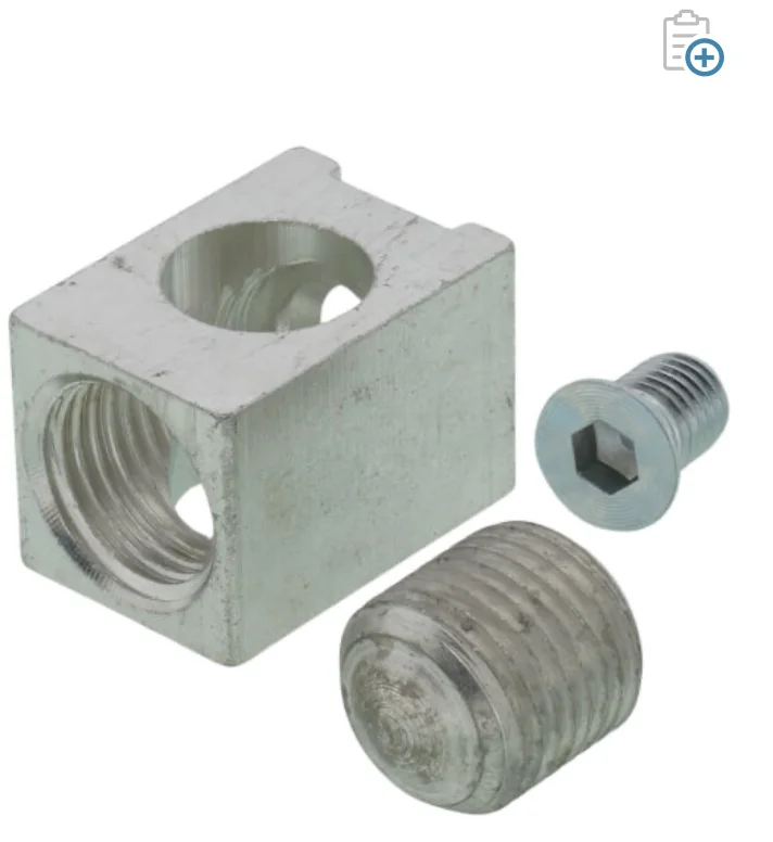

The one shown below will work for certain. It is Seimens EQ III, PL, ES. & takes #4 to 2/0. Part number US2:ECLK2
I suppose a hardware or Supply House Com will have it.
