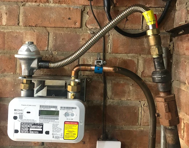

I have a Gas meter in a detached garage, do I have to have 10mm bonding to it direct from the MET in the house, the garage has a CU fed by 4mm swa, it has10mm bonding to the gas boiler gas feed in the house ?.

You should have a 10mm bond from met
