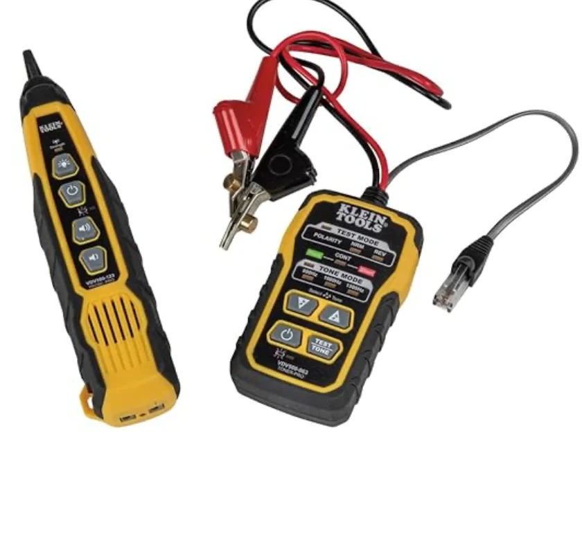

I'm not a residential guy, General, but I'd probably de-energize everything in the box and use a Tone Generator. Check all boxes in the room to find the unknowns. Careful- The boxes you open may have energized conductors in them. (At work, everything is in pipe so the job is much easier with a Wire Sorter. If your house is piped, this would be the quickest way.)
Klein makes a very good tone generator with a strong signal for about 80.00 USD. There are also no-name ones for far less. Samples are below.

@General_Valeria, I second using a tone generator. The dead wires you're seeing were the switched loads that the fan's remote receiver was controlling. The two hot wires were simply supplying constant power to that receiver. Using a toner is the quickest and most effective way to trace those dead wires back to the switch box without having to open up every box in the room. Just make sure the power is off before you clip the toner to anything like @PGB1 said. Once you've identified the correct switched leg, you'll be able to wire up your new switch and fixture properly.
