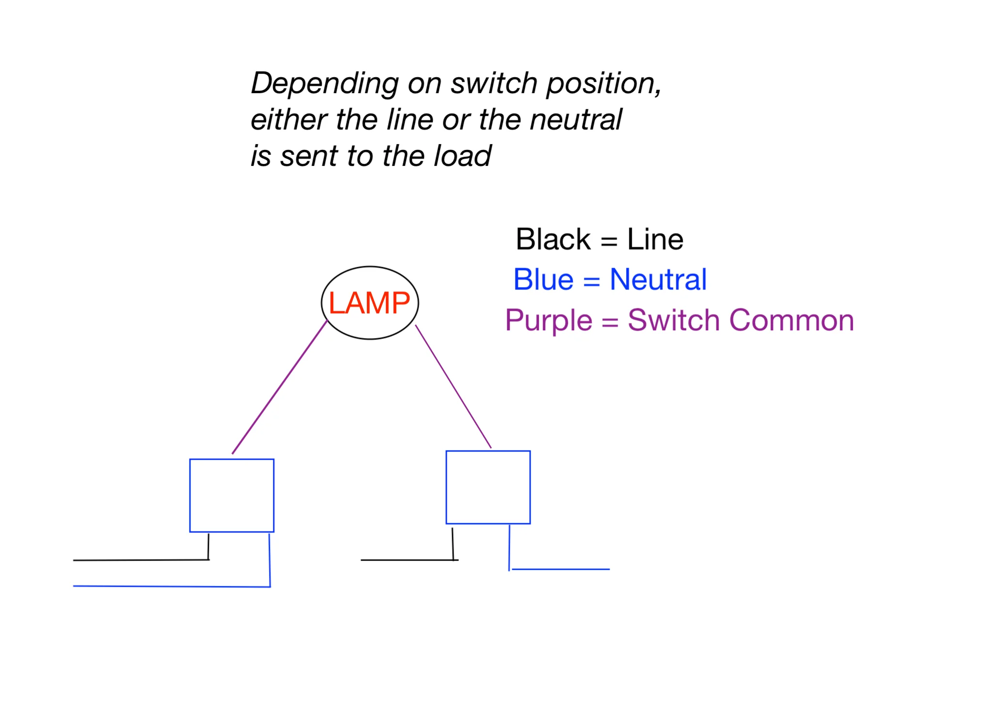

We encounter Carter & Chicago in early 1900's industrial facilities often.
Below is a quick sketch which may help explain how Carter works.
In the sketch, you will notice that, depending on switch position, the load either has two line going to it (lamp off), two natural going to it (lamp off) or one of each (lamp on)
The scary part its when someone rearranges the overcurrent devices in the load center or panel board and ends putting the line side for the switches on opposite phases. But, it does not last long because the fuse opens or the breaker trips.
Note that Chicago is essentially similar. And, for DC buildings, instead of switching line & neutral, it would switch positive and negative.
